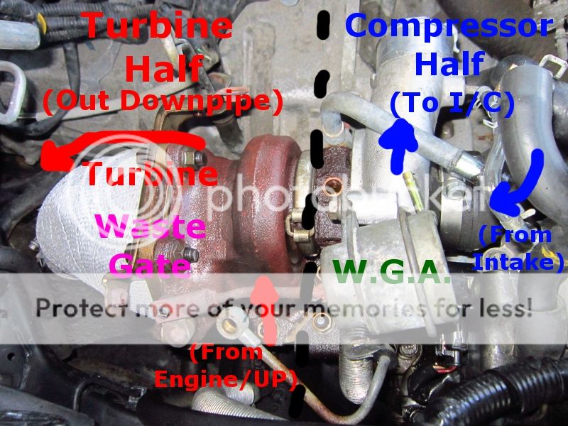

Turbocharger Construction:
The turbo has three main 'building blocks'. The turbine, the compressor, and the bearings in between. The hard part about the turbo is understanding that both the compressor and turbine must be fit to a given situation. I will go over the Wastegate Actuator (WGA) later in the tread. Just left it there in the pictures for you to note for now.
Thanks to Zax for the turbo pictures in this post. I took them from him... along with some noods which you can't have.

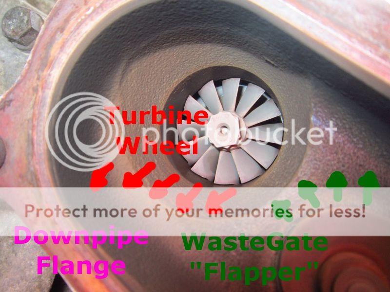

Turbine:
The turbine is one of the two devices you stare at if you take you downpipe off. One being the wastegate (will cover that later), and the little propeller type wheel commonly known as the turbine. As (extremely) hot gases leave the engine, pass into the headers, and through this half of the turbo, the heat and speed of the pulses is transferred into rotational motion. Think of blowing on a pinwheel... then think of using boiling water to spin the pinwheel.
The turbine properties will greatly effect your end outcome. Too small of a turbine will cause excessive exhaust back pressure on the engine (even before your down pipe)... Too big and it will not 'spool' up in a reasonable amount of time. I'd like to emphasis the first point there - regardless of if you want a fast spooling turbo... too small of a turbine will hurt performance - a lot!

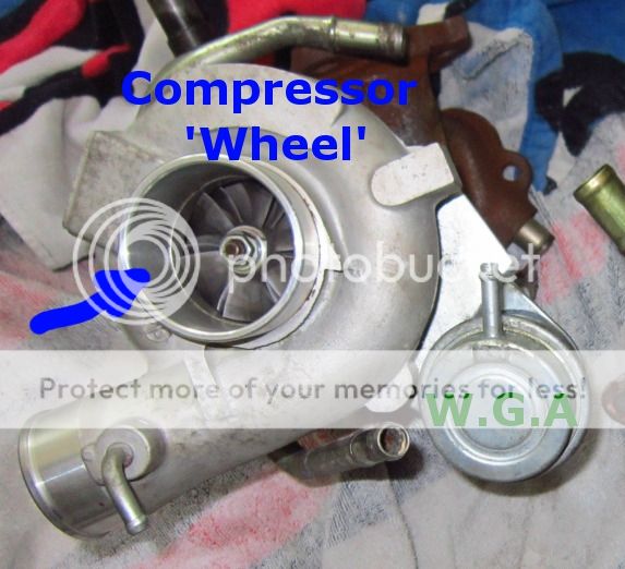

Compressor:
On the other end of the shaft from the turbine.. you'll find the compressor. It's important to realize we are now on the other side of the turbo. Instead of this device being between the engine and the down pipe... this one is in between your intake and your engine/intercooler. As expected... the compressor will in fact spin along with the turbine... but it will compress the air in the intake tract of your car and spit the hot gas out to the intercooler.
The compressor properties will also effect your end outcome. An improperly sized compressor will stall/surge, or be out of its efficiency range (big problem - will cover that later). It's important that both the compressor and turbine match the application!

Okay... Now that we understand the two basic halves of the turbo, there are two related topics to take into consideration - variable geometry & boost control.

If you aren't familiar with the waste gate, it is simply a hole placed in parallel or beside the turbos turbine. There is a small spring loaded flapper that covers the hole normally - forcing all the exhaust energy through the turbine. As the pressure against the flapper increases (or the spring pressure holding the flapper shut decreases), it pushes the flapper open and allows exhaust energy to go around the turbine (and not speed the compressor up).
To put it another way... the waste gate on your turbo is a way of creating a variable geometry turbo which you can actually control! Even if it is just a small hole with a flapper that covers it.
