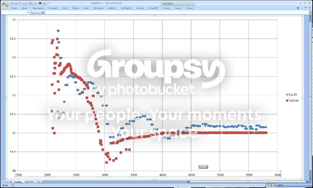

    Anyhow, you'll want your target fueling and your actual fueling over the RPM range, as well as any correction to apply over the MAF voltage range. I log Final Fueling Base (FFB) and use that. Others have interpolated their open loop fueling table using a spreadsheet. I prefer to use FFB, because it shows what the ECU is actually aiming for. In the newer ECUs, you see some rather large 'undefined' compensations here and there.
    I'll leave my formulas in text so you can see them. My target fueling is equal to 14.7/FFB (From the definition file), and the correction I apply is equal to actual/target. It may be better to use a percent error formula, but this seems to work for me as is. I do round down my corrections. EDIT: I used (lc1-Target)/lc1 this time around, and it appears to be a better way to go. Open for suggestions on this one.
    ...And drag 'em down.
    Click your RPM column header to select the entire column, then ctrl click both your lc-1 and TarFuel colums... Scatter plot 'em. I suggest just moving the chart to a worksheet to make it easier to see. A lot of the detail is lost unless you format your graph correctly. Size both axis to show as much resolution as possible. Add major grid lines to the horizontal axis. And lastly, I change the page size to 8.5"x14" to get a bit more viewing space.
    This is a well formatted (slightly sloppy fueling, but not too bad) graph. See how much detail you can pull off of it?
    Next, plot your MAF Voltage against your Correction factor. Format appropriately. You should be scaling the vertical axis from about .8 or .9 to 1.1 or 1.2 Mines unusually sloppy here:
    ^That should be the change you would apply to your MAF scaling. It does fluctuate a lot when the wastegate opens... I doubt yours will be smooth either. I will probably apply the changes from 3.3V and over though.
    Finally, browse down your Injector Duty Cycle column. You shouldn't see any numbers past around 85% most say. If so, you are pushing your injectors pretty hard. It's something to keep an eye on - I'm pushing 90% in the 4-6k region.
    Just about covers it for fueling.
