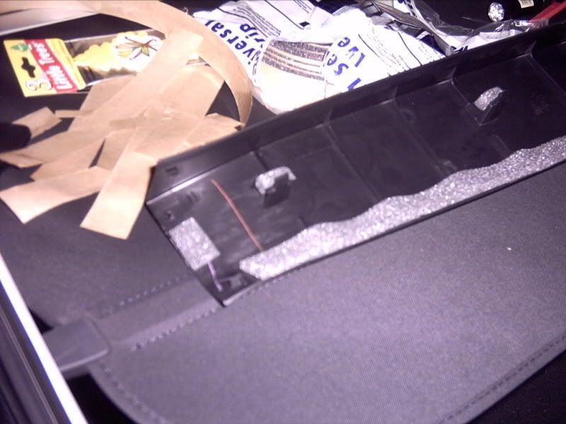

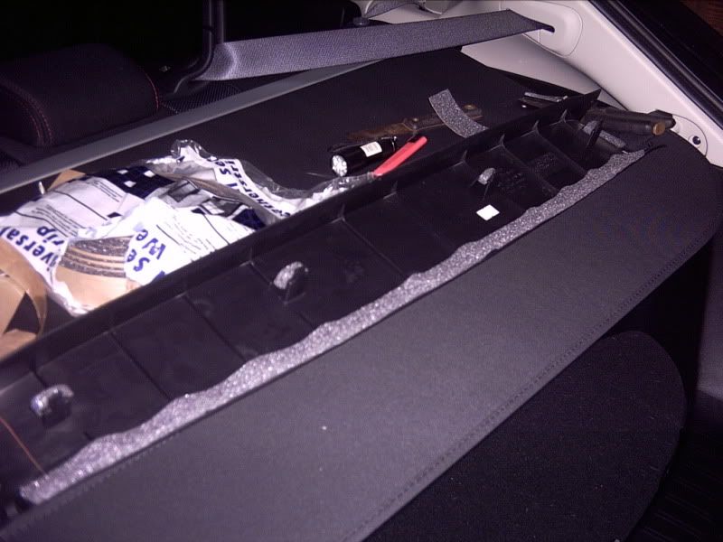

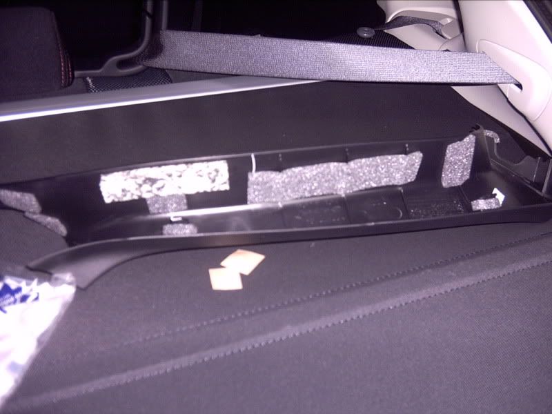

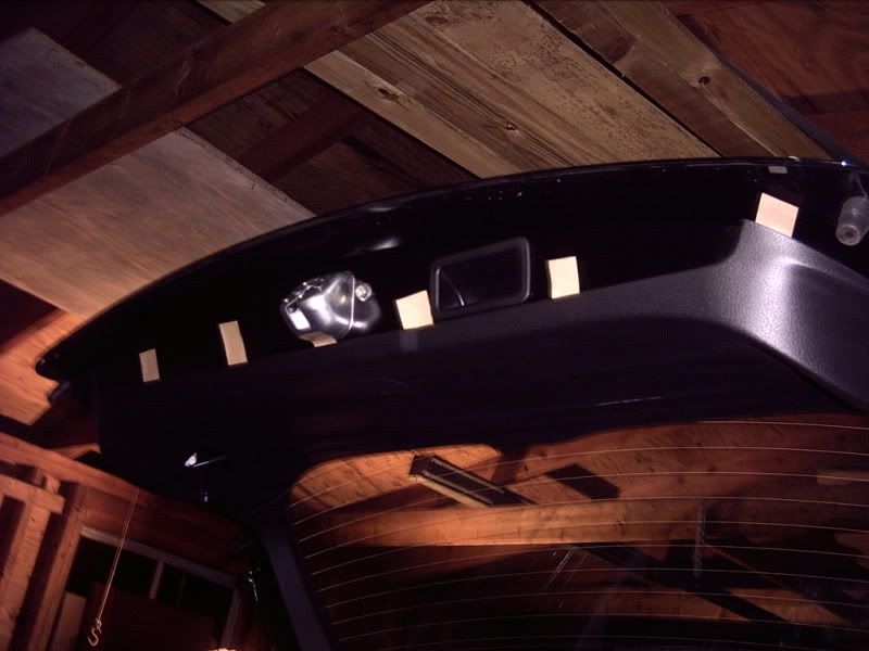

If you're getting a squeaky noise.. this is likely it, what I did for mine was to rub off all the fuzzy stuff on the ends, got them as clean as possible and squirted some silicone lube on where they contact the interior panels and where the tensioner slides on the alum channel. Cured the squeak.
However if you're getting more of a rattle or plastic on plastic tangy kind of noise its likely the trim around the hatch. I pulled all mine and put foam weatherstrip behind the panels to eliminate the rattle. If you open the hatch and tap around on the panels you can kinda reproduce the rattly noise.
The strips here are in place to show where I put foam on the inside of the panel
You'll also notice that the hatch rattle subsides as it gets warmer but the cargo cover squeak will get more prominent when its warm.
I put the foam on probably 35k mi ago and not a peep out of it since.
