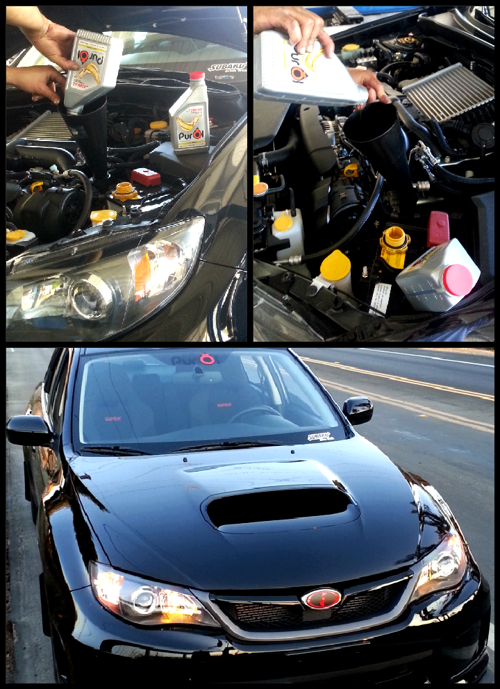

If you're not too concerned about it because you know the dealer that services your car, understands the benefits of such "boutique" oils, then why not use something that should and would protect your engine better than a standard API type oil lubricant? FYI: I bought a gallon of Motul 5w40 from local dealer who would also service my new car with it prior to getting PurOl.
Porsche, Audi, Ferrari and Subaru enthusiast are now running PurOl based on proven results from chemical and mechanical engineers, its dyno tested to increase power, that's what I'll be running.
The thread asks "what oil should I use" - Basically, I guess if you know your service dealer will give you a hard time about it (should some engine damage occurred related to oil) then I would suggest stick to OE Subaru dealer synthetic only. Use whatever is best based on your knowledge, judgement and resources.
You'd be relying on the word of someone that works at a specific dealer that running the wrong oil spec will not be the cause they chose to deny your warranty claim. Words are worthless. The guy may retire. He may change his mind. A claim may change his view. Everyone's your brother till the rent comes due.
Now if the expensive oil meets the spec then no worries just keep dated receipts. That'd be ideal.
Even then though, consider that I've generated single-digit wear data using less expensive, widely available oil from a much better established firm. Since getting even lower wear numbers isn't statistically significant when the data are that low, I don't actually see a reason to risk a "boutique" choice.
If you decide to run that other stuff though it'd be interesting to see used oil analysis data from your motor. They probably buy their materials from the established firms but it's interesting to see how their choices might affect wear rates etc. They might be quite good. Thanks for link.
Edit: I got curious and searched for data; there are no data on that oil on Bob's site. Do you happen to know of any UOA links?
