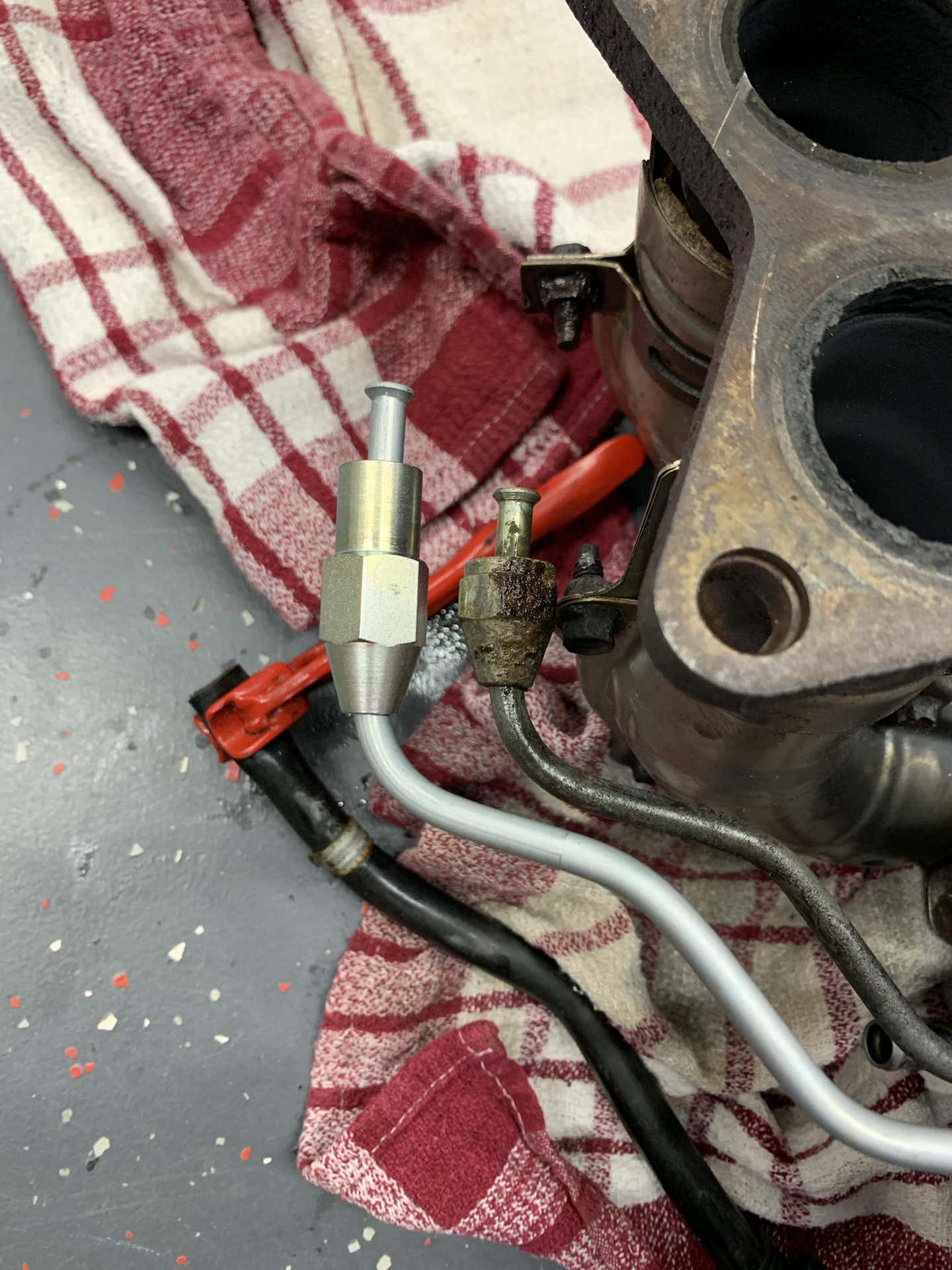

Anybody ever eard of an aftermarket oil feed line for the 2015+ wrx?
I need a replacement oil line part#15192AA732
Subaru said it’s discontinued, replaced by part#15192AA760
Subaru dealer confirmed me with my vin# that is the case. Wanna know the good news? It’s not even close being the same, so what do you do with something so stupid?
Replacing the full line attached to the motor is sounding like stupid way to do it…
Edit;any inputs on the size of the an? Fitting would be great!
Recycling my original one will be plan b.

#14 ·
On my journey to figure out something that works. I decided to try it with the extra length and maybe rebend a little if needed the brand new oem line.
My guess is that clearance will be minimal if none with an adjacent water pipe. If thats the only problem I can probably figure something out.
That would eliminate the steps of cutting the tube and making a new double flare.
In the photos; Green is showing the stock location original line which is now discontinued.
Red is showing path of the new oem replacement.
None of the picture shows the “on-turbo” exact location, that is just an estimation of the path. Handheld.
Sent from my iPhone using Tapatalk
#16 ·
revisiting this post because we just did my headers last night and replaced the turbo as well and turns out the new line (15192AA760 which is now replaces 15192AA731 ) came with my replacement turbo and will not fit. Anyone know of any solutions to this aside from buying the entire new hard lines from Subaru and waiting a week if not longer to get them ? I live right by summit racing but unsure what AN Lines and etc to get because above it was never updated. someone wanna help a brotha out.
#18 · (Edited)
Subaru dropped the ball with the updated feed line not matching. The best bet is repurposing your old fitting or having a custom turbo oil feed line made using 4AN braided hose and proper adapters. I had a similar issue on my FA20 build and ended up using Earl’s parts with a 90° elbow to clear the water pipe, no leaks since, and easy future access.
#19 ·
Subaru dropped the ball with the updated feed line not matching. The best bet is repurposing your old fitting or having a custom line made using 4AN braided hose and proper adapters. I had a similar issue on my FA20 build and ended up using Earl’s parts with a 90° elbow to clear the water pipe no leaks since and easy future access.
I thought about doing something similar when I was into the work. But I didnt feel like spending on trials/errors about getting the correct set of fittings. Untill I figured out that cutting the tip of the new turbo line enabled me to hook it up to the old line from the block.
You mentionned 4an Line. Thats one piece of the puzzle, do you have more specs about each fittings you used to hook onto the hardline from the block and the turbo feed?
That could be usefull for someone else or in unknown future.
Thanks
