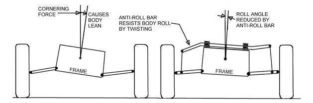

Swaybars (anti roll bars, stabilizer bars, etc.) limit the amount of body roll your vehicle will exhibit while cornering by increasing the roll stiffness of the suspension. The swaybar is attached to the suspension arms to limit the independent movement of these arms.
As the body of the vehicle rolls into a corner the loaded suspension arm (outside wheel) will apply an upward vertical force into the swaybar while the spring of the opposite (unloaded) side will apply a downward vertical force. These opposing forces create a torsional deflection in the swaybar. A larger swaybar is better able to resist this torsional deflection and therefore will transmit more of the force from the unloaded spring into the loaded tire limiting the amount the body is allowed to roll. The stiffness of your springs will directly affect the effectiveness of your swaybars.
