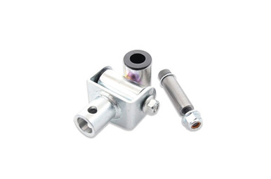

#4 ·
Hmmm I know these things can be 'sloppy'. If all is well there, this may be a issue with the linkage to the transmission. Did you change or check out the front pivot point? I believe the spring pin can wear out and get loose. This guy
#9 ·
I cannot believe this, I couldn’t find a video that showed it properly before but that video showed me exactly what I was looking at when I replaced the bushings and there is just no spring there in my car… I dont even have to look I remember wondering what those little hinges were for and now I know they are for the spring😂
