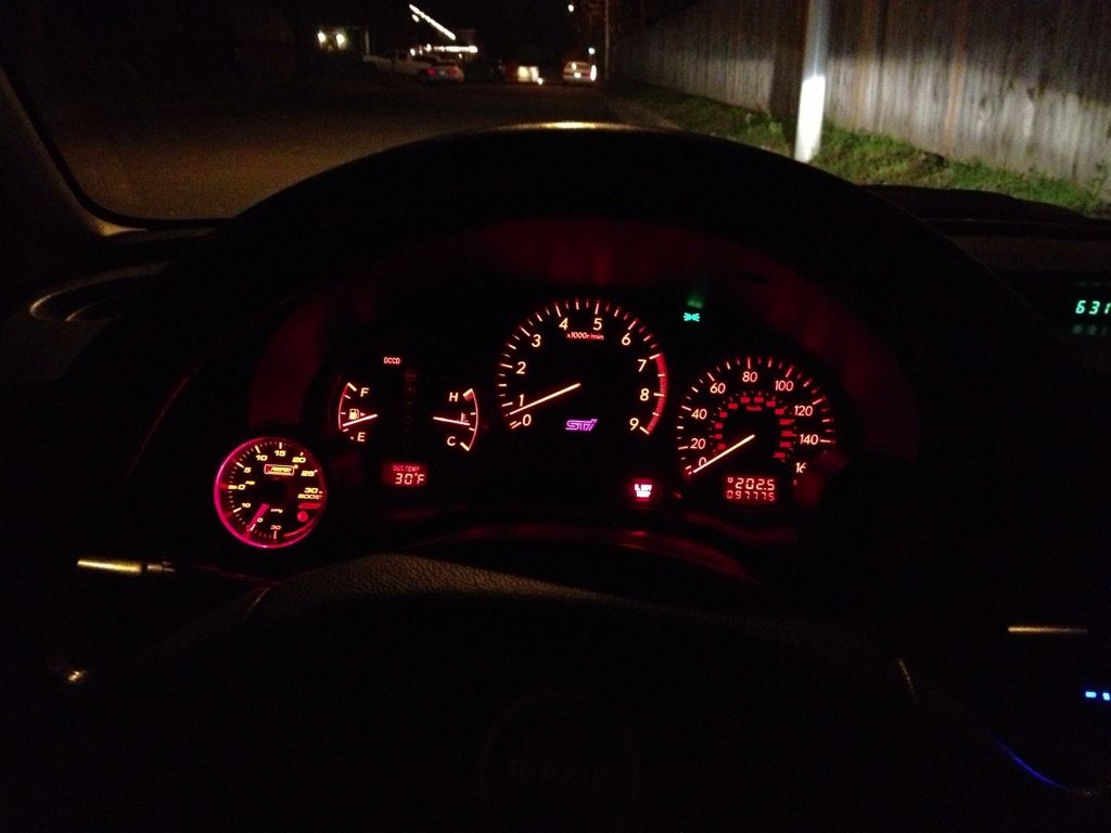

Here's a short video of the STI cluster installed. It's becoming my favorite mod by far. It only took a day at Tacoma Speedometer, ended up being a $100 including shipping, and took 4 days from the time I shipped it, to when I had it back (their shop is only 2.5 hours north of me though).
I just need to get an OEM OAT sensor, then I can finish the air temp circuit and splice that in. Pulling the speedometer takes 5 minutes, so no problems there.

If you get a 2004 STI cluster, it's plug and play, aside from clipping the B28 wire. It takes all of 15 minutes, more if you want the outside air temp gauge to work properly and if you want to turn off the diff. temp warning light (WRXs don't have rear diff temp sensors).
