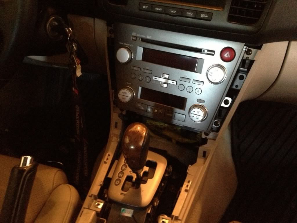

Starting in 2007, the Legacy stereo (sourced from Clarion) was available with XM Radio. Instead of that, you could substitute iPod connectivity using the same controls (but removing the XM functionality). The kit contained a small interface box, all required hardware, some patch cabling, and instructions.
Removing a Legacy/Outback stereo isn't as easy as the Impreza/Forester. You have to remove the faux wood trimming, the shifter trim, and a ton of little clips. It sucks:
Further complicating things, the automatic climate controls and stereo are melded onto the same circuit boards:
This makes an aftermarket stereo setup pretty much impossible without tremendous expense. Even with the pricy JDM panel swap, the trim colors don't match, and the DIN unit looks very out of place compared to the rest of the dash. I don't want to hear any whining from WRX owners about stereo swaps, lol. You have it easy.
Anyway, the ipod kit is pretty easy to install: just remove the stereo, bolt in the interface box, plug in the cabling, run the ipod cable into the armrest cubby, and that's it. Unfortunately, the controls aren't intuitive at all. Playlists aren't organized the same way as the ipod, navigation is pretty tricky, and the whole business is just way more difficult that it needs to be. Thankfully, I usually only have one playlist for the car, so once I'm in that, it's easy enough to just let that play. On the plus side, the steering wheel buttons can control the ipod too, which is pretty impressive for a 2007 factory deck.

nice upgrade! sorry it took a totaled wrex to get to, but looks great none the less. boo on the intagrated ac/hazard/stereo. kinda kills even a pricey head unit upgrade but the ipod fix is cool. glad you found a way to work around the block of meh. i wonder if the hvac circut is seperated on the inside of the stereo housing. you know, something that can be removed for later custom of a uber head unit, while keeping the cool. kind of like the guy that fabed a set of guages into his hvac control switch erea and mover the controls.....down, i think. cant remember how he did it, it was on nasioc i think on a bug eye.

Yes, It has AM/FM, a 6-CD changer, an AUX input, and now full iPod control; all from the factory deck. The CD changer isn't worth much to me, but hey, it's there. While it plays burned CDs just fine, the song information won't display (it just says Track 1, 2, etc). The iPod control of course shows the song/album/artist/playlist/etc names.
As far as relocating the HVAC controls on a bugeye, sure, that would be fairly easy as all the dials and buttons are either potentiometers with electrical leads out, or cable actuators. The vent dial for example just pulls a bicycle brake type cable to swing the various ductwork dampers into each setting. As long as you have enough slack in the cables and wiring, it doesn't really matter where the control box is.
I don't think i can separate out mine since the HVAC control ports are right in line with the audio output ports, meaning they share circuit boards. That level of hacking isn't worth my time when I could get a sound processor and be done with it.
