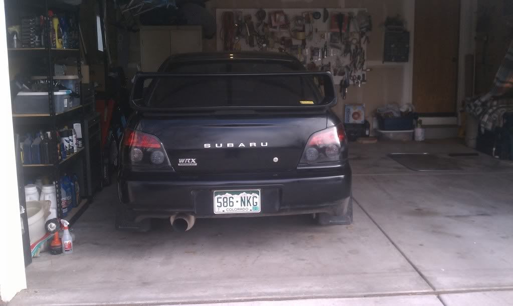

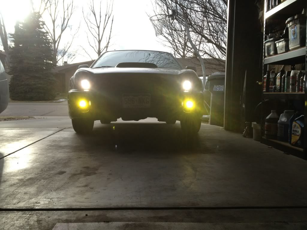

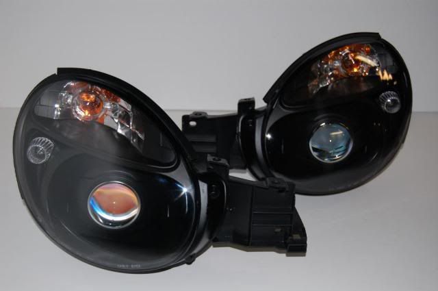

Well, being that Sinister refers to me as the Lighting Wh0re, I think it is appropriate I start a lighting thread. Use this thread for discussion about lighting, both interior and exterior, showing off the lighting mods you have done, etc etc. I will start with the lighting on my bugeye. Here is the lighting mods list and some pics:
Interior:
LED Dome Light (48 LED's)
LED Map Lights (12 LED's each)
LED Trunk Light (5 LED's)
Modified Clock - Red numbers
Modified HVAC - Red LED's
Modified Key Ring - Red LED
Headlights:
Lightwerkz Retrofit
Clear lense FX-R Bixenon projectors
Morimoto 5Five (50w) Ballasts
Morimoto 5Five (50w) D2S 5000K bulbs
Theretrofitsource 9007 wiring harness
Ocular Shrouds
Chrome covered amber turn signals
Chrome covered hyper white running bulb

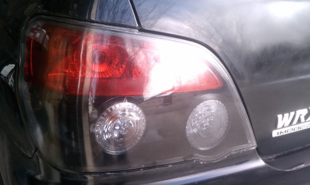

Taillights:
07 Tail lights
Painted lower housing in metallic gunmetal
Lightly tinted

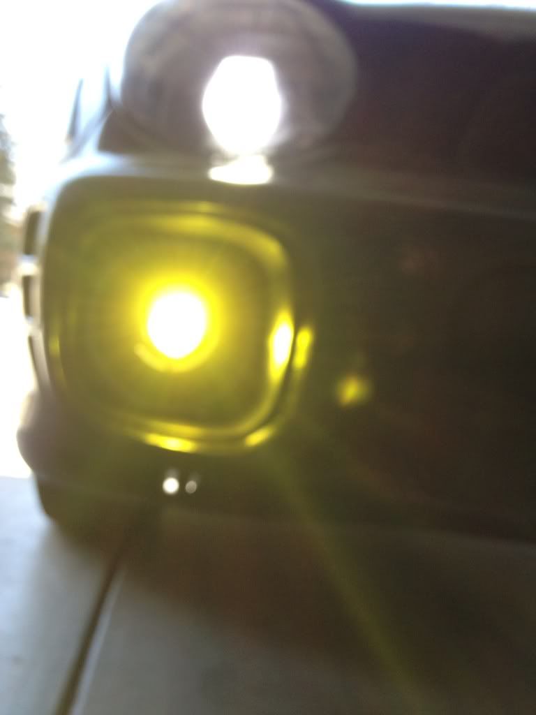

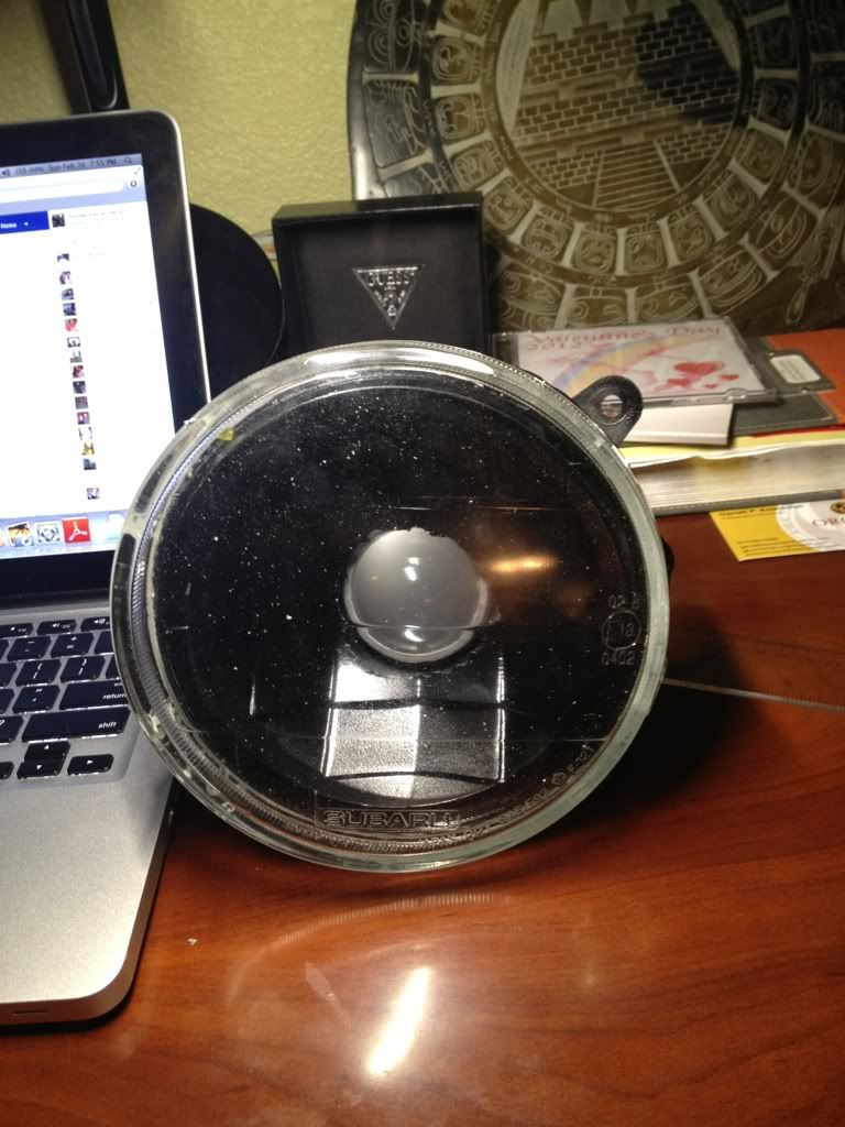

Fog Lights:
Stock 03 fog lights
Retrofitting with Lexus IS300 projectors (clear lens)
Morimoto 3Five (35W) Ballasts
Morimoto 3Five (35W) 9006 3000k Bulbs
Theretrofitsource H1/H3 wiring harness
And here are some pictures:

Tails:
07 STI with LED stop and brake (have no recollection where I got the bulbs)

That would be sweet. Should be a 7440 since they are 07 tails.

are the LED brake lights brighter than stock?
Slightly. But the more important thing is the bulbs have about 35 LED's each. So if one or two (or 10!) fail you still have tail lights/brake lights. I have been running them for close to 4 years now.

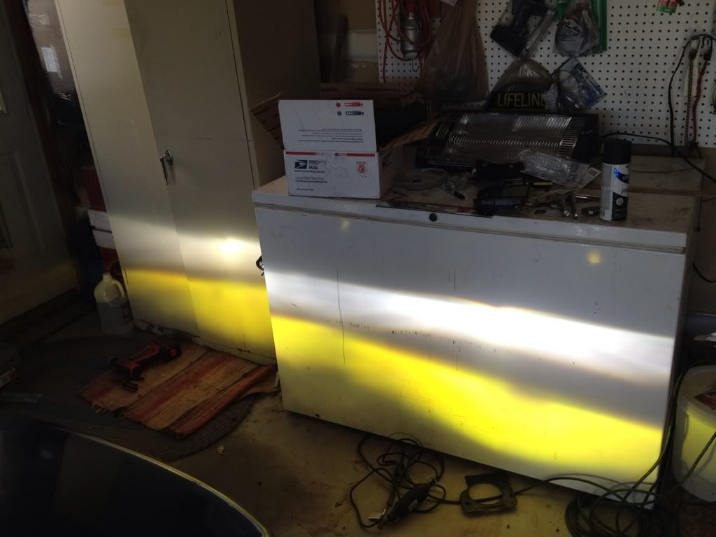

Well after finally getting to drive with my fogs at night without being around street lights, I can honestly say they make a big difference even with my 50W HID retrofit. I plan on completing the Independent fog light mod in the next day or two and I honestly think my fog lights by themselves are brighter than most standard headlights. They have a low cutoff so I wouldn't use them as headlights but either way it is impressive. If someone were to use them with stock headlights they would outshine the headlights by far
¯\_(ツ)_/¯
5,808 Posts
What do you mean by "outshine"? the stock low beams aren't intended to illuminate very close range (that's what fogs are for). If your fogs are outdistancing the low beams, then the cutoff needs to be much lower. My fogs basically end where the low beams start, with maybe a foot of perceived overlap from the driver's point of view. I think your projector fog mod is neat though!

By outshine I mean brightness close to the car. They are definitely quite low and don't extend very far but they are very wide and bright. And honestly, as bad as stock bugeye headlights are without a good bulb upgrade, it wouldn't surprise me if they are pretty close in usefulness.
