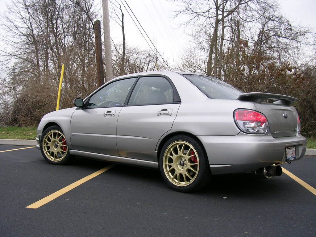

Greetings!
So..... with the arrival of the new wheels and the recent Suspension mods.... I've decided to create an "all-inclusive" thread... with all the mods I've done so far.... and when I do more, just add to it, rather that keep creating new threads.
It's gonna be LONG..... with LOTS of pics.... and I'm going to keep it going every time I do something or take new ones. And I must admit... I'm proud to say that absolutely everything done, was one by me, with hand tools, in my garage.
Starting with EXTERIOR/SUSPENSION MODS:

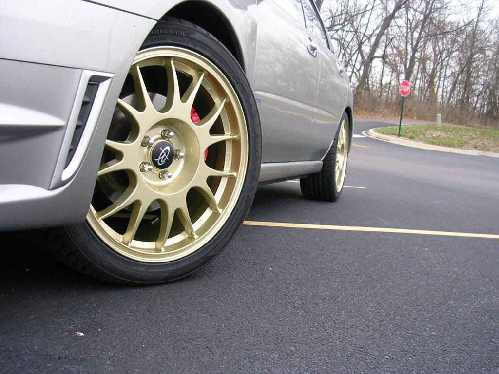

Rota 18x8 GOLD Formula Mesh wheels
Kuhmo Ecsta SPT tires 235/40/18, 280 treadwear
Eibach Pro-kit springs (1.2 front, 0.8 rear)
SPT door logos
COBB Tuning license plate frames

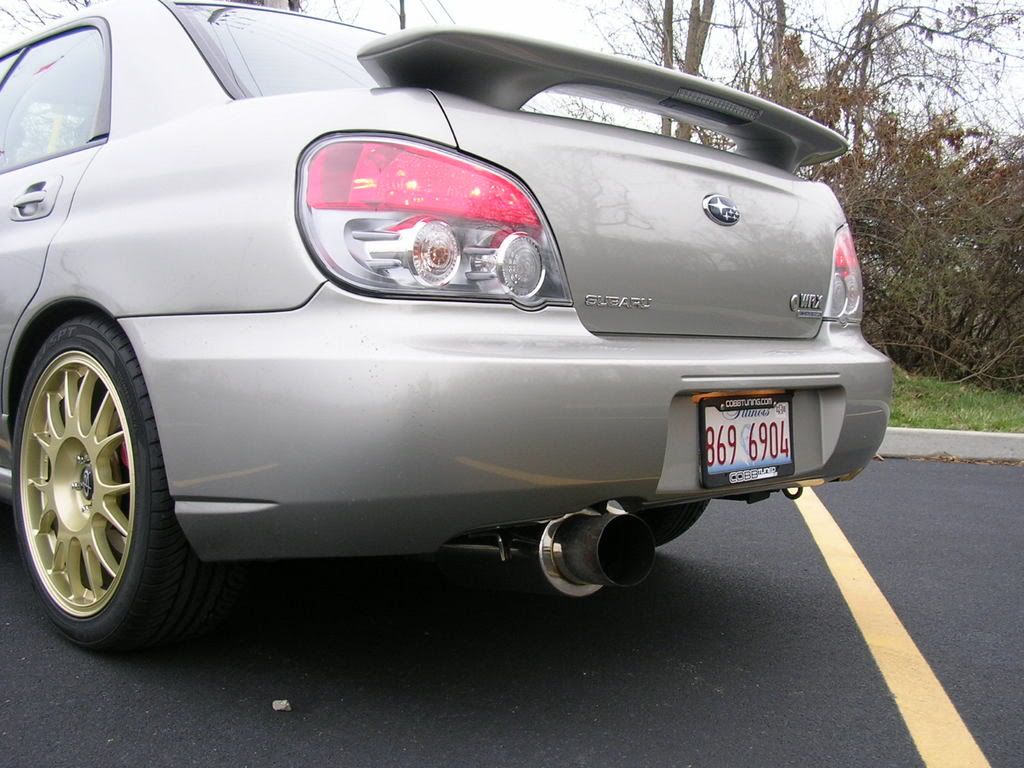

Now onto ENGINE, ECU MANAGEMENT, AND EXHAUST
K&N drop-in filter
Removal of intake silencer and Air intake duct
Subaru Fender hole plug
Factory STI Intercooler
Factory STI Splitter and rubber bellows
COBB heat shield
X02 Racing full 3-inch stainless steel Turboback exhaust - Full Cat delete
Subydude short shifter
Perrin Shift knob
Perrin Polyurothane bushings
COBB Accessport V1, Currently running stage 2, 93 Octane

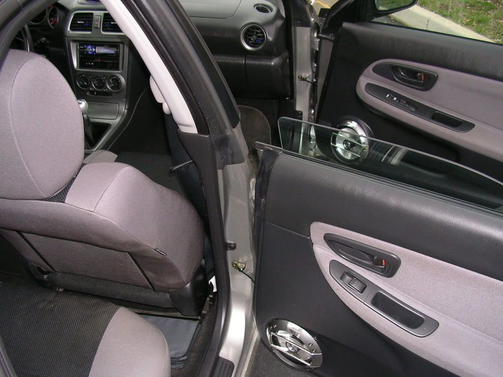

Rockford Fosgate 6.5 aluminum dual coaxial speakers (front)
Rockford Fosgate 5.25 aluminum dual coaxial speakers (rear)

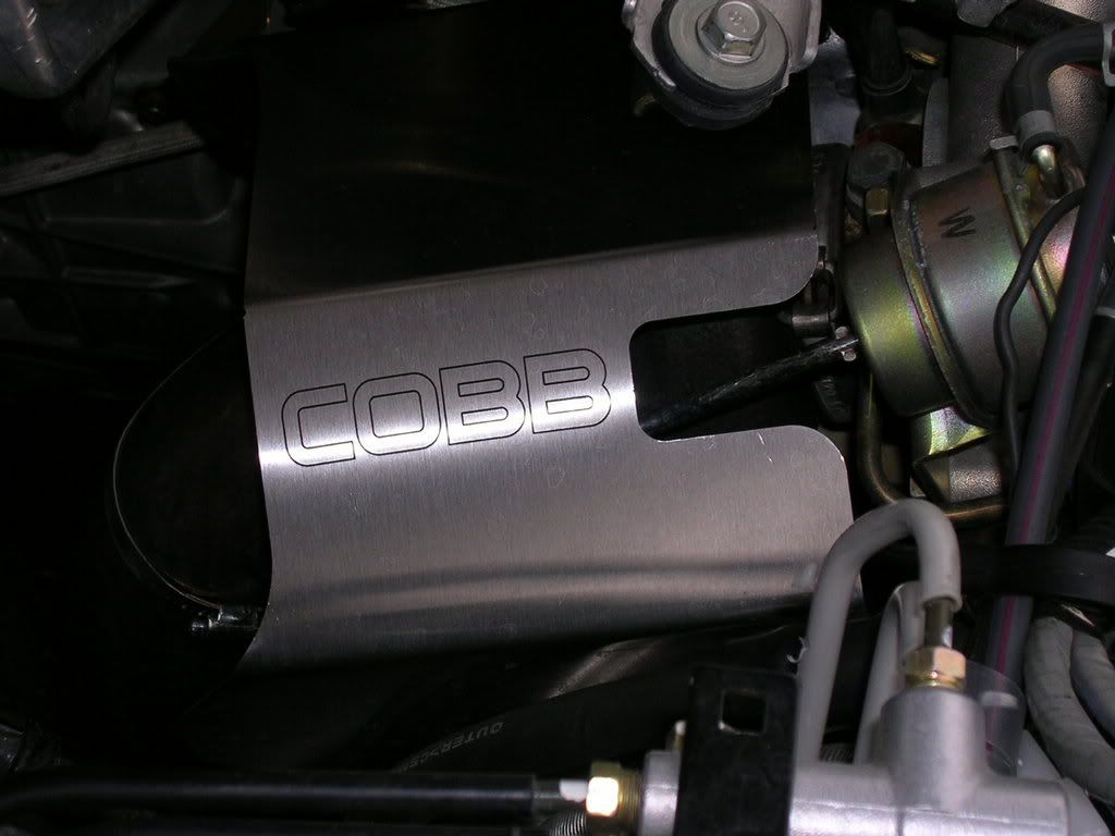

how does the cobb h/s fit...does it rattle and what mounting points did u use?
It fits great...... can't reuse the factory heat shield unless you cut the crap out of it to fit around the DP.
It attaches with 3 bolts...... to the factory bracket.
I did have to trim about 1/4 inch off the inside corner.. it was rattling against my tranny... all fixed now though, 100%

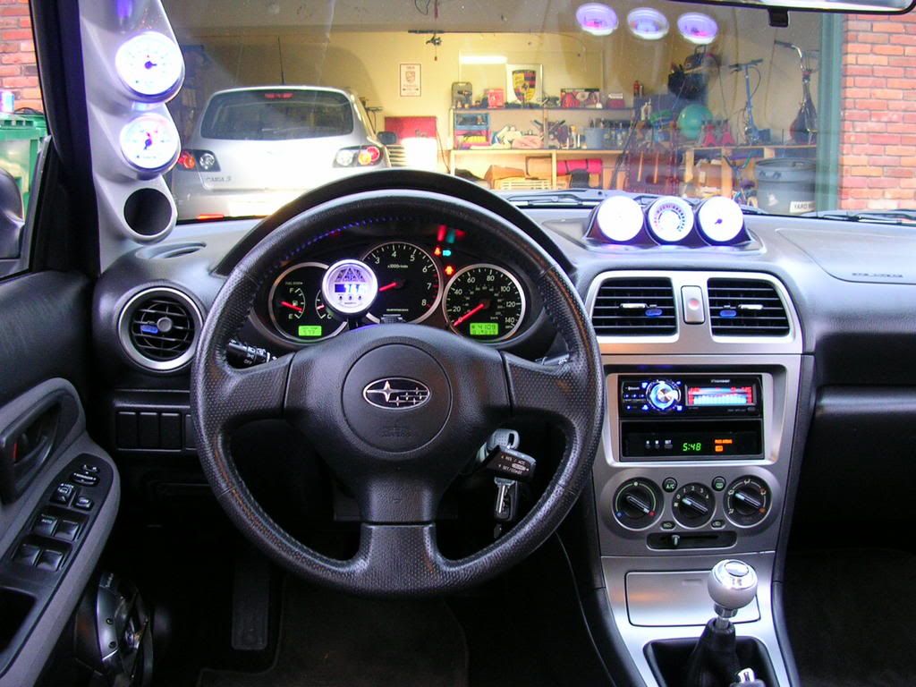

Ok..... so it's done.... pre and post intercooler temps....... next step... Intercooler sprayer. I was actually surprised with the results. The post I/C temp really doesn't change much at all. Stayed right at 110, only fluctuating maybe 5 degrees.
The pre-I/C temp generally runs 15-30 degrees hotter.. depending on how much you get on it.
I imagine adding 90 degree weather, and an intercooler sprayer will change these readings dramatically.
So I started with the Perrin Silicon Ypipe I bought from Ben-no (BTW.. thanks). This is actually quite nice.. It flows MUCH better that the factory STI Y-pipe.... I noticed a definate improvement in torque.
And then I did the same thing to the inlet tube. Senders are tightly mounted, and secured with high temp silicon.
Then of course, two SPI Air temp gauges... mounted low on the passenger side of the center console. I had to trim the pod a bit with a dremel, to "tilt" it toward me.
Wired everything up, and reinstalled everything:
Then..... I installed my "stealth switch"..... To detract attention when I dont want it. Basically, it's a red LED switch (on the center console empty tabs), that when turned off....... dims all my gauges (doesn't cut power, just the lights). Just to give you an idea of what my disco-car looks like on the inside when driving at night... I intentionally took this picture without a flash..
And now....... my "stealth switch"... turns off everything but the tachometer (and factory stuff)
WHATTAYA THINK???

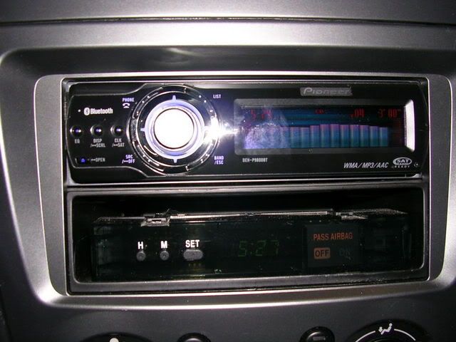

Did you just take the standard clock and relocate it? It's the ONLY thing that stands out as not being super cool. Who needs a clock anyway man just get rid of it ;-)
"Supreme Subaphile Extraordinairre"
1,274 Posts
Discussion Starter · #14 ·
Thanks!
Yea... it's just the standard clock.... I did have to splice in and extend the 5 wires that run to it though, because the factory harness wasn't long enough to run down there.
If it were just a clock... It'd be gone.
It's also a passenger side airbag indicator. I've got a 8-month pregnant wife, and a 10 year old daughter... I don't mess with safety features...
Thats why I haven't upgraded the seats or steering wheel.... I won't mess with airbags.... some stuff is just too important.
