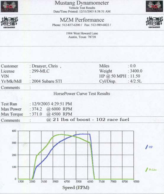

Have been talking with for MZM performance. Now its time to go all the way with the STI. they said i will be looking around375 wheel hp!! what do you think of this kit?will do the install and have MZM install the e-manage and will also do the tuning

That's the setup I'm looking at when the UTEC comes out, SR50 but with 20 exhaust housing, 850cc injectors, UTEC, FMIC, yatta yatta and a good tune. I'm hoping for 400whp on stock block.

It is easy to get over 400 whp out of the STi. THe SR50 gets maxed out easily which is why only 375 whp. Still it is quite good. The stock turbo is maxed out at around 310-315 whp. See my results below. Be careful Truckerspeed. The GT37 is NOT a ball bearing design and has no water cooling. Only the GT25R, GT30R, GT35R, GT42R and the upcoming GT40R are ball bearing units and water cooled. THe E-Manage is actually super easy to tune. It is almost as easy to tune as the UTEC. I love it for it's user friendliness. Our GT35R kit stage 4 package will be capable of over 500 whp but the block will not sustain that so we are working on the Spec R bolt on turbo which will sustain 400 whp while being bolt on plug and play. IT is based on the GT30R.
