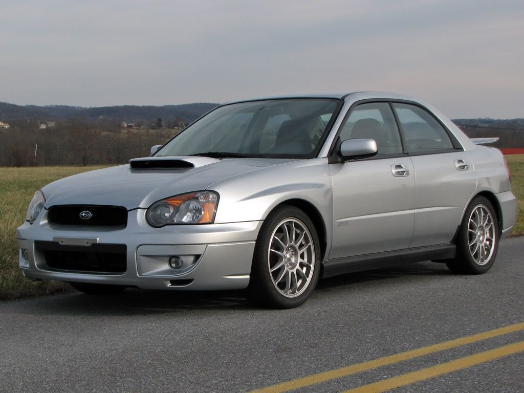

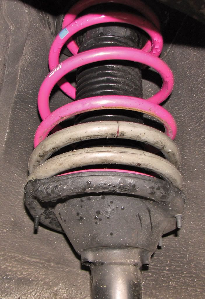

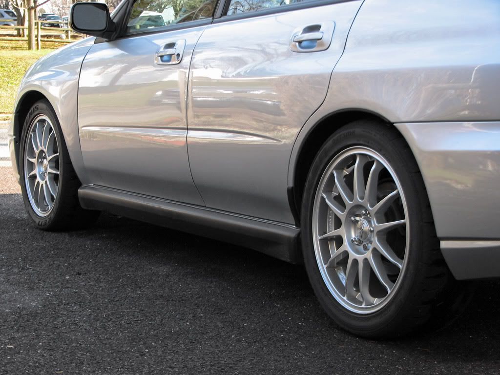

… and in the pink. 2005 STi struts, JDM pink springs and GroupN rear top hats. Better ride and handling and a nice drop too. A huge thanks to JR (wrx wagone) and Tristan at The King of Parts. Could not have made it happen without you.
NO I am not painting my side skirts now, so don’t even bother. :p

Yes indeed. I had the SPT v7 STi setup. The JDM pinks have higher spring rates and an improved ride. Amazing.
I temporarily put my summer wheels on today to test and experience the difference. I will likely need to take them off tomorrow as ice / snow is forecast. :sadwave:

is that a mis-type on 05 STi struts? They are a non fit for the WRX (unless one does a hub/knuckle swap)
Drop looks good :)

No Mike, that's not a mis-type. Bill had the SPT dealer installed suspension option which included the v7 STi struts.
During this install we were going to reuse the front struts an only replace the rear pair as they had the dreaded "04 STi strut clunk". That was until I was torquing one of the front top nuts and the top of the strut shaft cracked right at the bottom of the 6mm hex hole. Strut = done. :sadwave:
We managed to find a set of 05 STi take off struts local at 7pm on Friday night. After paying musical strut bodies on the front, we had a full set of 05 STi struts on the car. Notice the front struts are "cherry blossom red"? ;)

How is the ride? Any harsher than stock.
Have not been stock since April 2004. The higher spring rate pinks have a smoother more contolled ride over the v7 SPT setup - noticably less harsh.
