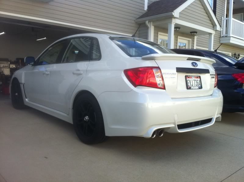

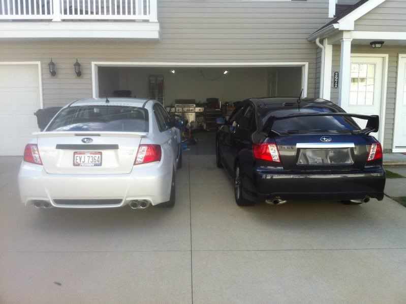

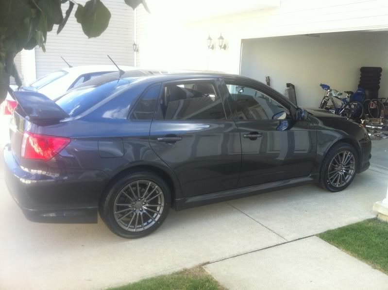

so ive had my 11 for some time but i never posted here about whats been going on. i got rid of the 09 because the interest rate was higher, the payment from a trade in was higher, the car had 36k on the clock and i didnt want to have to redo the motor, tranny, clutch, paint job etc etc. the 11 is costing me a whole bunch less and its nice to have brand new!!!!!!!!!
so i swapped over everything from my 09 to my 11 and i have been busy busy with a bunch of new parts. ill try to add in whats been going on.
Day 1 i went ahead with both cars at home thanks to having friends at the dealer and i swapped over my 15 lb battery, my light weight Racing Hart 18x8.5 +44 wheels and Conti DW 245x35x18, and last my Koni adjustable shocks with RCE Yellows.
