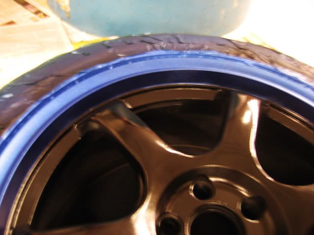

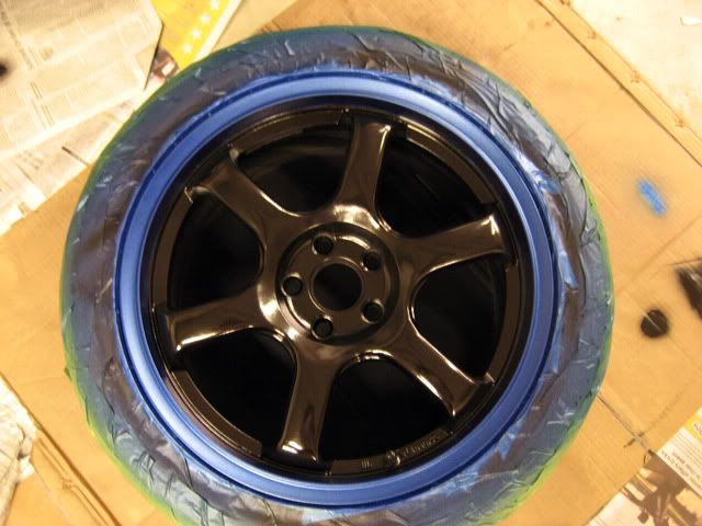

well for whatever reason i seem to really enjoy customizing my wheels. i could never seem find a glossy black rim with a blue lip. so i decided to try my hand at making my own. was one of the more complex paint jobs ive done and i think it came out very nice! Everyone at the shop thought it looked pretty sweet too. now i havent pulled the tape off the tire because i still need to clear coat the blue lip. oh and the blue paint is called "Metal Specks" by duplicolor. it really "pops" in the sunlight. and i plan on getting some blue Ray's lugs to tie it all together.

Probably not something I would have picked but it's certainly unique and it looks like you did a good job. Post pics when you get them on the car.

thx man i think so too! the the blue is actually pretty close to WRB so i think it'll give it that little extra something without being over-the-top.....like my ORANGE stockers i just painted! :rotfl:

What "trick" did you use? Just carefully masking it off? It looks like a really clean job. I personally wouldn't have chosen blue, but as you said, to each his own :thumbup: Seeing them on the car might change my opinion, too...
to paint the blue part i over-masked the rim (the tape actually went up on the part that was to be blue), then the part of the rim where the spoke actually "attaches" to the rim is a "crease", so i just took a small very sharp box-cutter and used the "crease" as a guide to cut off the extra tape. then you just got to tape the bulk of the rim off. it was pretty easy really. then to paint the rim shiny bllack i just reversed masked it. except i went along the little ledge above it. so the trick is to have something to keep the blade even and on track as you cut around the rim.
