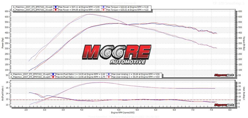

This is probably the most desirable powerband I've ever seen in a Subaru:
2007 STI (single AVCS) with Kelford 264 cams (link)
Obviously, there are a lot more modifications on that build, but you can't deny that's impressive. Yes, JR made 1200+whp on his Subaru, but I would rather have this.
Yes, dyno numbers vary, so take the absolute values with a grain of salt, but these are DynoJet figures...
Show me another Subaru with:
550wtq/400whp @ 3750 RPM
625wtq/500whp @ 4250 RPM
>500whp for ~2750 RPM
This would be incredible to drive on the street.
I've heard several builders mention that D25/W25 heads benefit most from added lift vs. the duration of a mild cam.
I can't imagine that powerband is the result of ONLY a cam and not some mild PnP.
Per the build thread:
Kelford 264/260 Duration, 10.70mm/10.20mm Lift.
Stock heads.
I would agree that lift is probably the biggest factor, but the duration helps keep the powerband where you want it for street driving.
Edit: NVM, I was reading the horsepower as the torque curve. It's what I expect out of OEM heads.
You say that's a perfect torque curve, but I'd want a bit more drama. Horsepower peaks then holds for 3000rpm. Not my cup of tea.
Sent from my SAMSUNG-SM-G890A using Tapatalk
Street car, which is what 90% of what people on the site would be using the car for. That is enough power to likely break traction on even high-end summer tires, even at 255/35/18 (closest match to 225/45/17 that comes factory).
Please show me a better street powerband.
In addition to what I mentioned above, 450+whp for 3500RPMs.
You know what I would do with a car with that type of powerband on tap all the time. Stupid stuff.
Sent from my SAMSUNG-SM-G935A using Tapatalk
300wtq by 3000rpm, and still holding 500wtq to 7000rpm?? :eek3:
