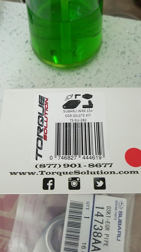

The bulk of my recent parts list is out for delivery!
  • Grimmspeed 3-Port Boost Control Solenoid - Scheduled delivery 9/16/16
  • Torque Solutions TGV Deletes - Scheduled delivery 9/16/16
  • Torque Solutions EGR Deletes - Scheduled delivery 9/16/16

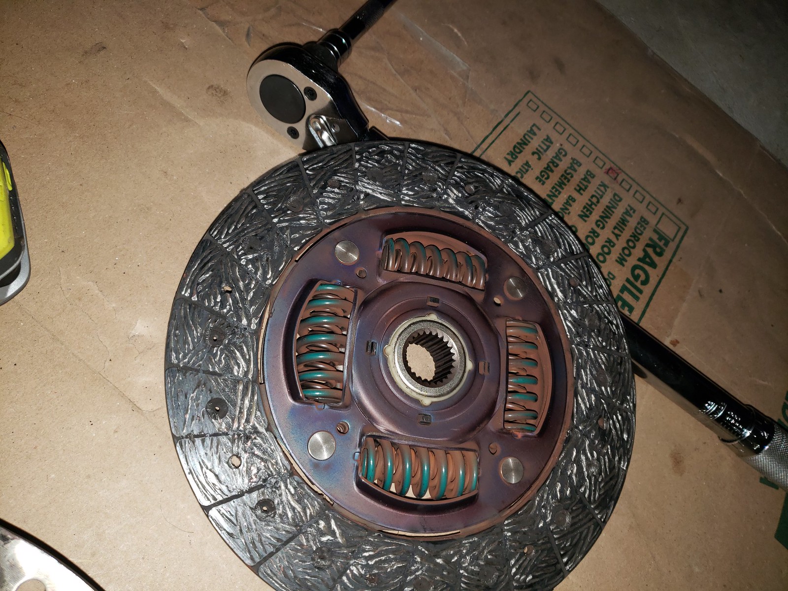

Update as of 4/9/18 -Installed the new ACT Clutch and Streetlite flywheel along with the Grimmspeed chargepipe.
Dissasembly (25,326 Miles on the ODO):
