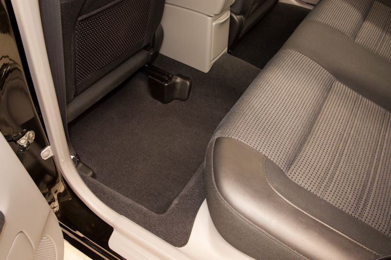

78 Posts
Looks awesome. If you don't mind, what did you do to get the interior so spotless?
1,071 Posts
That's a nice write up. Some of those driver side mats just never come out really good for me. I use our spot bot which is basically the same thing.
My wifes ms3 was soooo caked with dog hair I used gorilla tape on pretty much the entire car to get it out of the carpet. I tried everything before that. It did the job though and a pretty good one too. They are all short haired dogs or it would have been much easier!!.
