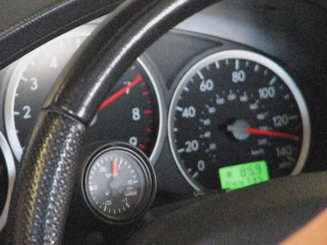

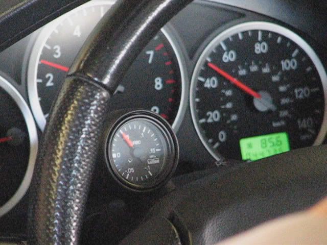

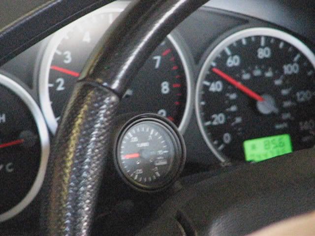

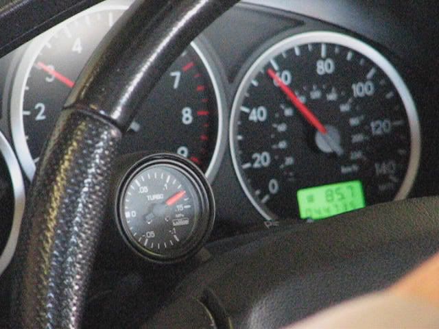

The gauge pics are stills from an .avi I shot while the WRX was on the dyno. They show just how fast and strong the boost comes on. In fourth gear full boost is achieved at a little over 3000 rpm. :D
4000 rpm
5000 rpm
Redline
