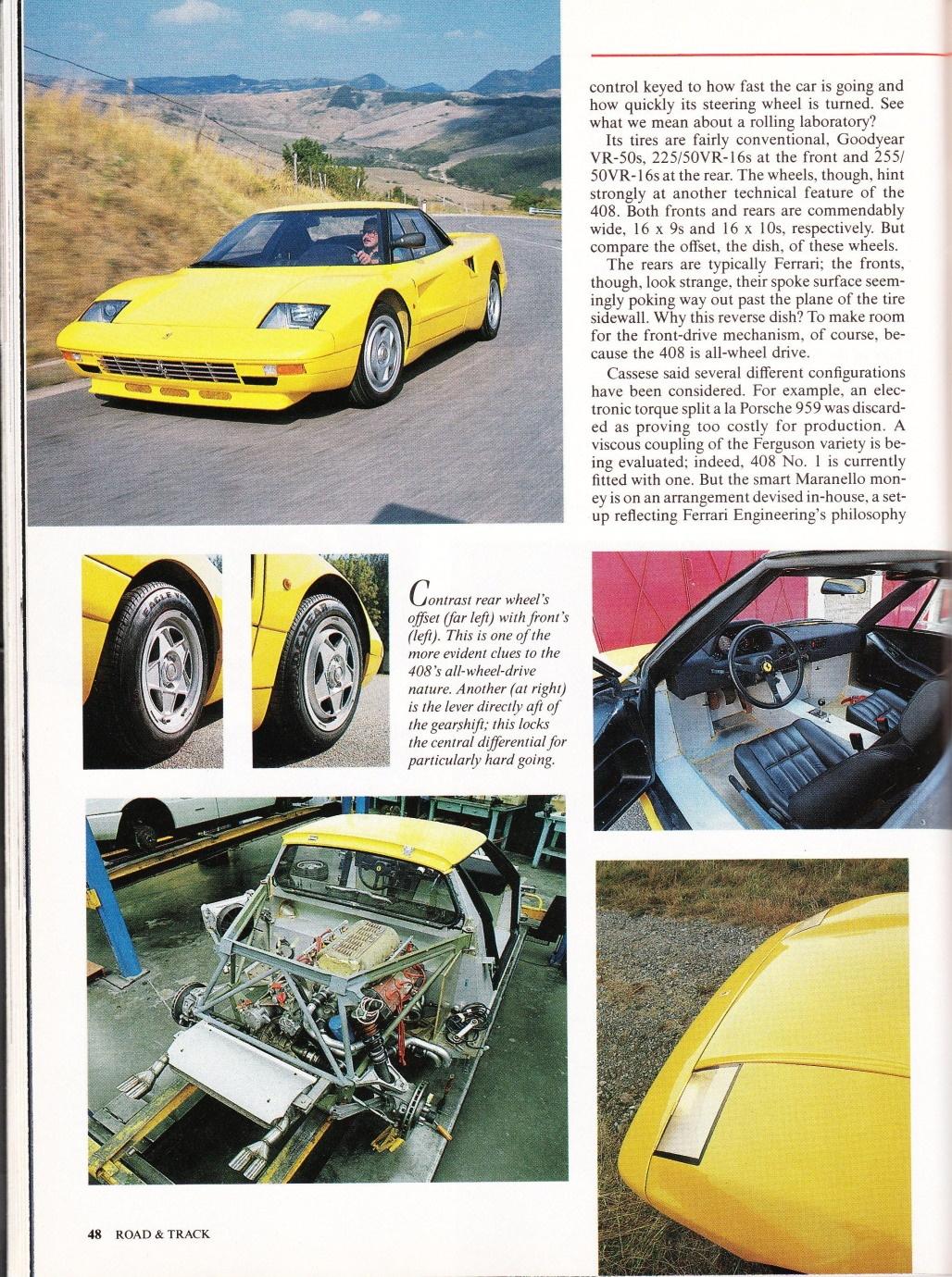

    He simply abides. SD_GR's Avatar
    Jul 2002
    CA, US
    20,368
    Aha! Here's a 4WD Ferrari (the 408, one of my all-time favs for two reasons: it was 4WD and it's rare). It's an excerpt from Road & Track and it lists front/rear stagger in tire width plus front/rear dissimilar wheel offsets. (The issue also featured another interesting car -- DSM. This was AWD, turbo, 2L, and catastrophically bad. I should know, I bought one. When I hear "DSM" or "4G64" I get hives... It ran identical 205/55s all around unlike the Ferrari).
    Now Ferrari have done many outright silly things but for the 408 they at least put the motor in the correct spot in the car (are you awake, Subaru?) so they could go wider in the rear, but that's another story).
