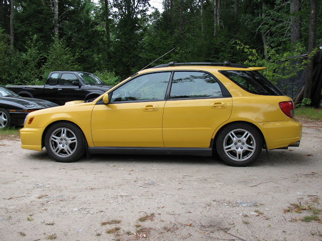

    I don't know if you can find the wagon springs anymore. Worth looking though. These are the regular guy black RCE (sedan). Basically the same as the wagon springs but slightly more rear drop (if any). The yellows would be even lower. 17x7" wheels 224/45 tires. Com C front '04 rear tophats, konis in stock struts.
    1.25"/1.0" F/R

    here is someone else's on RCE yellow's (more drop) probably with the rear 1/4" spacers.

    Quote Originally Posted by mycologist View Post
    I think I'll do one soon myself.
    Are you assuming these are Sedan Springs I take it?
