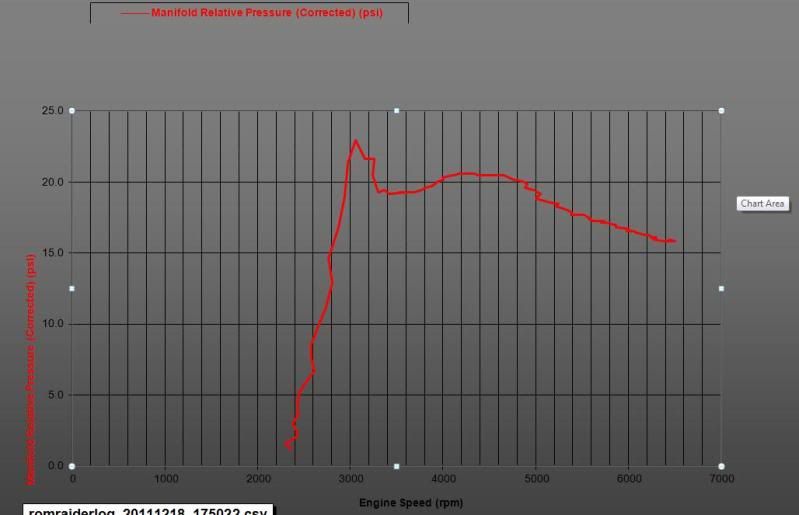

    so i decided to go a different route with the current motor set up. someone showed me some interesting things about blow through i never seen before. i knew the MAF volts, g/sec, boost and AFR were all a little wacky from it but i didnt know how much. im still not convinced that anything was dangerous because the car ran like a dream!! but because im OCD i needed everything to be perfect and smooth!!
    so today i swapped my blow through 3" MAF housing over to my CAI and added a large nipple to my TXS RFL BOV and a spot on the CAI. i still need to paint and re-shorten my MAF wire harness. but the install went ok and i like the way it turned out.
    so far we have just been working on the MAF scaling since it was setup for BT and now its a 73mm big CAI. tomorrow i will be doing some WOT runs hopefully and we will see if i gain/lose any power. one thing i do know for sure is the maps will look 100 times better!!
    here is my boost, my AFR and engine load, and MAF volts
    here is what a normal draw through setups should look like, big difference!
